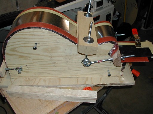

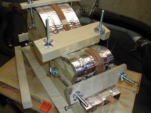

PostPosted: Fri Jul 08, 2005 3:02 pm
Posts: 688
Thanks for all the great advice. I still chickened out on bending the high flamed koa that Bobc sold me, but instead ripped one of his high flamed quilted sapele into bindings and tried that. I used a sandwich of thin roof flashing, and the blanket. I taped 4 bindings together and put them under running water for about 30 secs. Then wrapped them lightly in foil. I then put a thin metal flashing down, then the bindings in the foil, then the heating blanket, then another metal flashing piece. I let it heat for about a minute, and when I heard the sizzling, I bent the waste down. Then the cutaway, very slow, then the lower bout. I had no breaks and it worked beautifully. I'm sold on the sandwich method. Here are some pics showing the sandwich, and then one showing after taking the bindings out of the sandwich. I'll let them sit here until they are needed in a few months.
